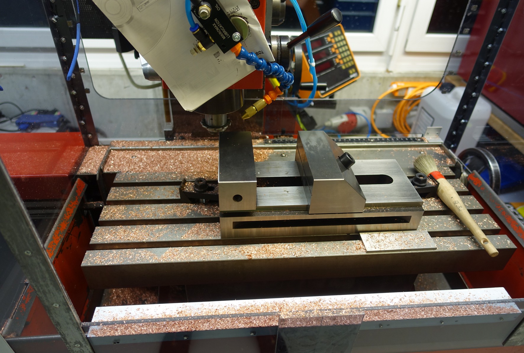

When I initially made splicer, only facilities I had in house was a Laser Cutter and wood / aluminum router. I always wanted to have a real metalworking workshop so it came that in recent 2 years I have heavily upgraded, to real albeit light milling machine (EMCO FB3), lathe (Sieg SC10), grinder, saws, stock, tooling, measurement, sanding equipment etc. It is amazing how much money you can sink into that and even then, you miss proper tools all the time. I put about 15k $ into it all.
Luckily only some parts I had to order specifically for splicer (1.75mm convex cutter that set me back almost 300$).
As a total novice in metalworking I read books, watched with fascination videos of Abom79, MrPete222, Keith Rucker and Metal Tips and Tricks, trying to learn. I went through stock material and tooling like through butter (Peng, there goes your 35$ spiral tap), but I learned.

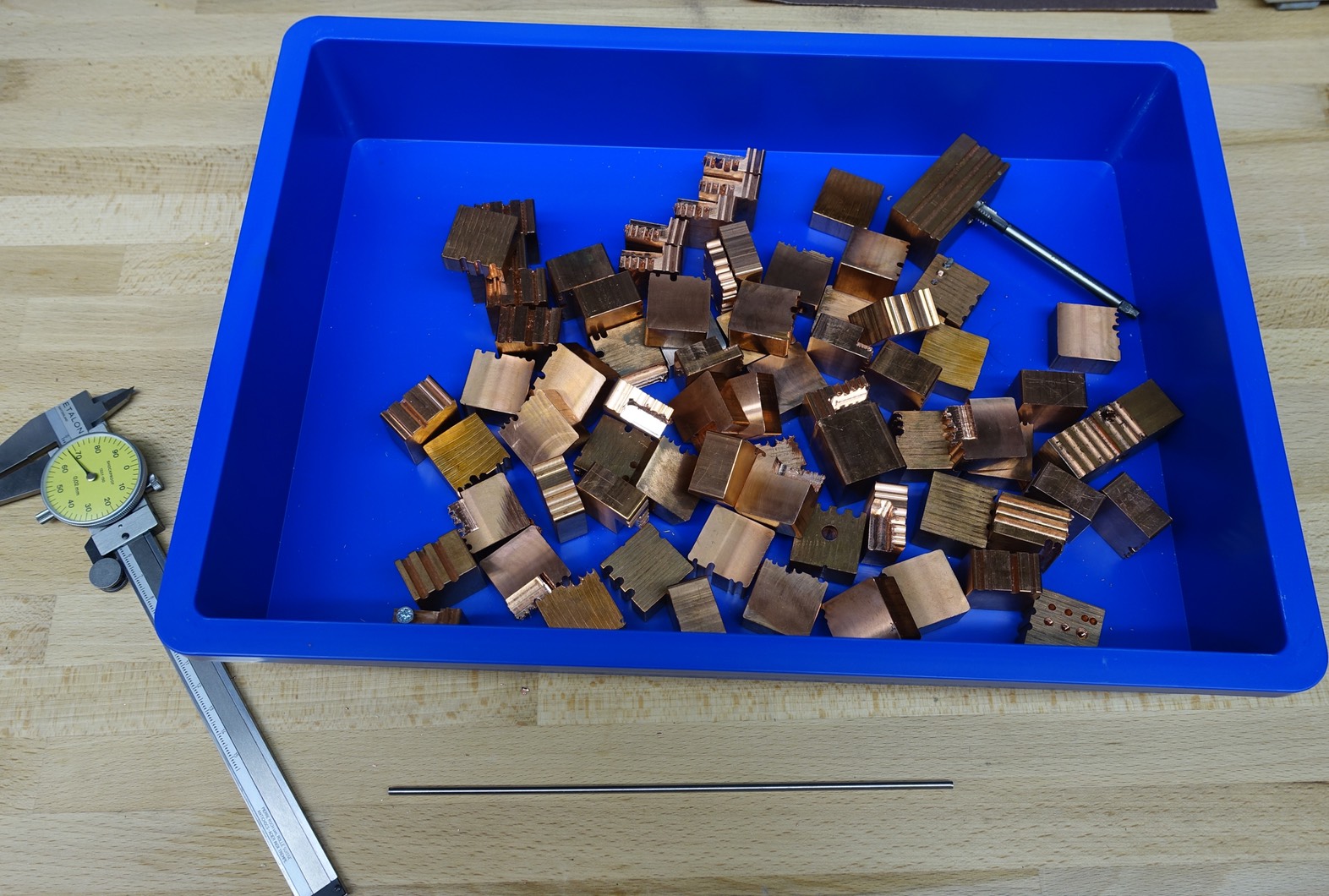

I produced several splicer copper components in house and it worked wonderfully, the final result was much better then prototype, I was very proud to hold those quite complex pieces in my hands and see how well they fit together. But there was one problem: It took me almost 3 hours for each splicer, so I had to optimize, not cut one piece at a time but do 5-6 of them, so I can spare myself entire re-alignment and tool changes.
THIS is where real problems start, you begin to realize how complex it is to align 6 copper blocks in perfect line, you make mistakes by mis-aligning work pieces or tooling and one mistake ruins not one but 6 pieces. You realize that your used milling machine has a problem in that Z-axis shifts by up to .1mm as you move table on X axis. You realize that your Chinese vice does not hold multiple pieces properly. And and and. But I went through it all, fought, learned and at last when I was left with enough stock material for 17 units I thought that I am ready. xoxoxo
I wanted this to be perfect, so before I started the “production” I brought my 3mm convex cutter to grinder company to ensure it will be razor sharp! I am sure experienced metal workers will see where I am going to here….. You see, when you re-grind your tools their diameter often changes… so when I got my cutter back it was not 3.00 but 2.75mm. And I forgot about it, it read R1.5 and I assumed it is R1.5. Fool!
My next mistake was not to control the cuts after each run. This was fatal, so after almost 10 hours of labor I ended up with total of 34 70% done blocks (main heating and cooling blocks), nicely cut but entirely useless since the slots where too bloody small for 3mm filament! And no, you cannot just re-fix blocks in vice and run larger cutter because it is impossible to get proper alignment again, especially with several blocks together. This was when I finally said F.CK IT and went to sleep. Next morning I thought to repeat attempt but then I remembered that I simply had no more stock material left. That sealed the faith of Splicer.
