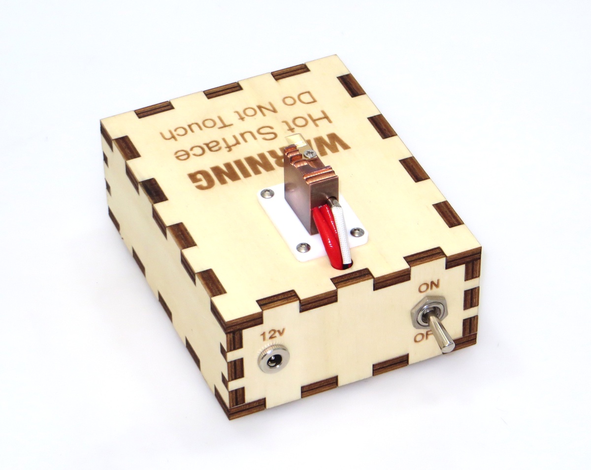

Why Filament Splicer
Joining filament by hand without assistance of specialized tool is quite cumbersome process, it often produces deformed and fragile joins which can get stuck in extruder / bowden tube or snap during high stress situations such as retraction or passage through extruder drive mechanism. The later is especially true with high quality, tightly coiled filaments such as low opacity PLA from Ultimaker.
Filament Splicer considerably speeds up and eases the process of joining filament.
1. Filament joined by hand, join requires post processing and is likely to be fragile.
2. Filament joined by Filament Splicer, no post processing required, solid join.
Features
- Small and ergonomic footprint
- Quickly setup and pleasure to use
- Suitable for 1.75mm and 3mm filaments
- High temperature range up to 235c, suitable for PLA and ABS Filament

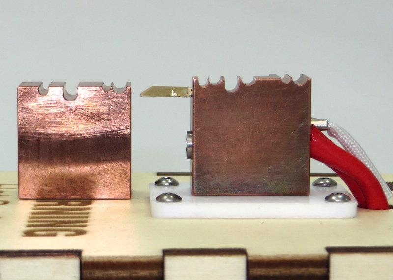

- Heater block made of pure copper with brass knife for cutting off excess filament
- Cooling block made of pure copper to quickly cool down and form joined filament
- Heat insulation PFTE parts are made of European PFTE with all appropriate certifications
- Copper parts are precisely CNC milled by our local partner company in Switzerland
- Works with 110v and 220v voltage

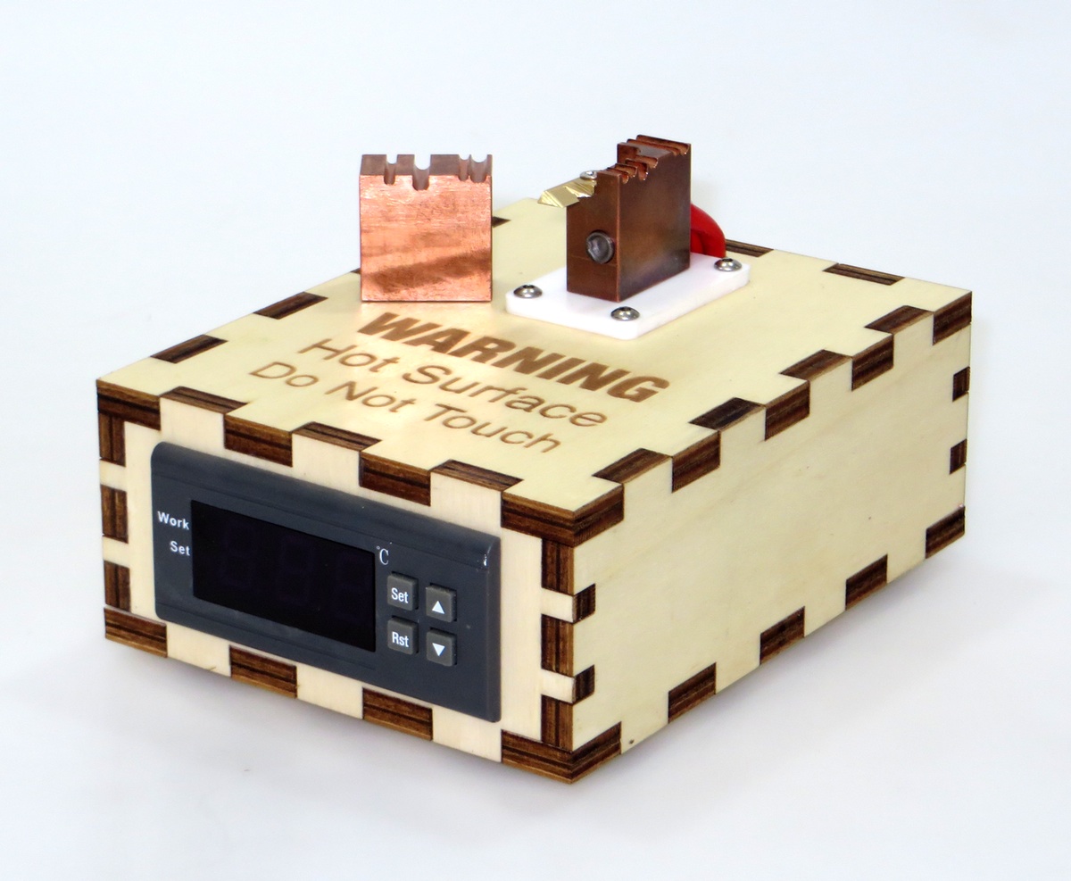

Usage
For small pieces of filament which can be rotated in fingers
- Hold filament pieces in both hands
- Touch heating block with filament ends for 1 second
- Join pieces in the appropriate groove on heater block
- Rotate filament ~360 degrees to remove excess plastic
- Move pieces into groove on cooling block
- Keep rotating in cooling block to ensure proper diameter
- One join takes less then 20 seconds to complete
For long pieces of filament which can not be rotated
- Join pieces in the groove on heater block
- Push filament into cooling groove, so that excess plastic forms a bulge above the joint, wait for 3-5 seconds
- Remove cooled filament and use hot knife on heater block to quickly cut off excess plastic
- One join takes about 15 seconds to complete
