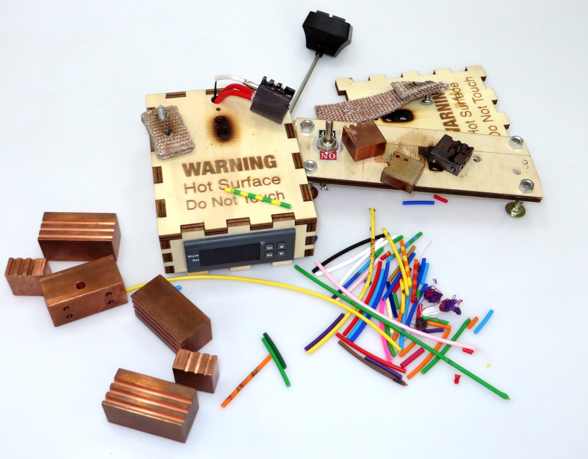

We have had our share of failed prints due to broken joints / stuck filament and finally decided to create a device which will help to splice filament. Initial idea was to create fully automated unit: you place filament ends on copper block, close it, push the button and viola - you have your joint. That was the theory.... In practice this is impossible because PLA and ABS expand during heat-up and contract during cool down, this results in either no joint at all or bubble-filled mess.
Many headache filled days [Even best PLA is really nasty stuff when you breath it in for a while] later we dropped the idea and went for 'open' model with precisely manufactured grooves which help to quickly heat up, connect and form joints.
Thermal insulation was another challenge, we wanted to allow up to 260c temperature but nothing could properly insulate enclosure from hot copper block for prolonged period of time. Ceramic fiber thermal tape can take that heat but one needs a lot of it and then there is itching... Chinese tape is horrible and even best branded, made in USA [ThermoTec] tape is not flawless. We eventually gave up on ceramic fibre and went with PFTA [Teflon] plates. Since PFTA can be outright poisonous at high temperatures, we decided to use high quality - made in Europe material - this way we are sure that maximum temperature of 235c is well within safety limit.

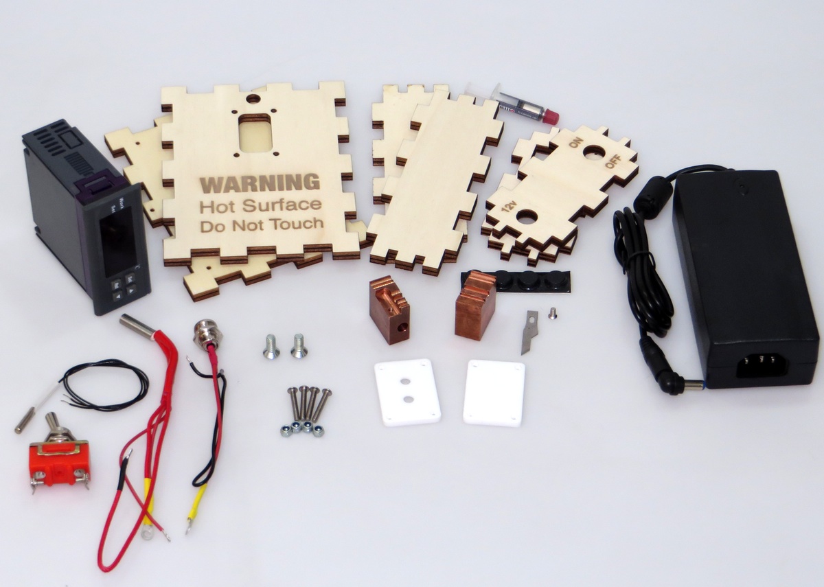

Availability
Filament splicer can be pre-ordered via our campaign on Indiegogo, it is available as a DIY kit or fully assembled unit.
